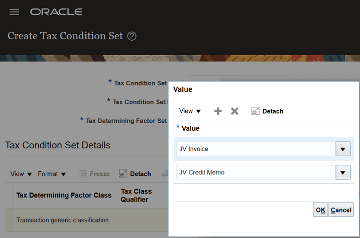

  9. On Create Tax Condition Set, under Tax Condition Set Details, review the record you created.
  10. Click the Operator drop-down list and select In.
  11. In the Value or Start from Range column, click the Select and Add button.
  12. On Value, click the drop-down list of the first row and click Search.
  13. On Search and Select: Value or Start from Range, enter “JV_” in the Transaction Type field and click Search.
    The search results will display the joint venture transaction types for both invoice and credit memo.
  14. Select the record for JV Invoice from search results and click OK.
  15. On Value, click the drop-down list of the second row and click Search.
  16. On Search and Select: Value or Start from Range, enter “JV_” in the Transaction Type field and click Search.
  17. Select the record for JV Credit Memo from search results and click OK.
    The following image shows that the Value dialog box opened on the Create Tax Condition Set page. The joint venture transaction types for invoice and credit memo are selected as the transaction types to associate with the tax condition set.
    This image shows the Value dialog box opened on the Create Tax Condition Set page. The details of the values entered in the fields are described in the surrounding text.
  18. Click Save and Close.
