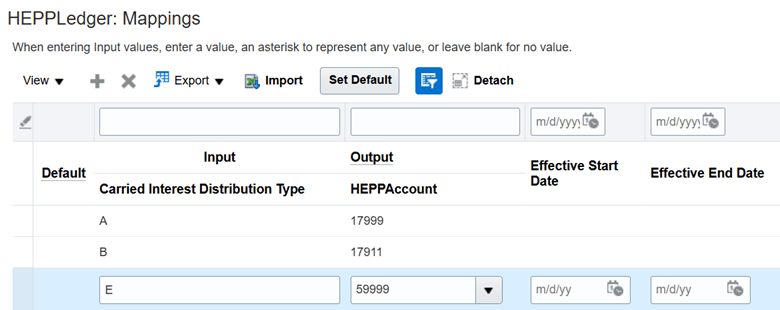

- In the Mappings area, add rows to map the following carried interest
distribution types from carried interest journals to the cutback accounts:
- A - Assets
- B - Billable Assets
- E - Expenses
The following image shows an example of the mappings for the carried interest distribution types.
In this example, HEPPLedger in the Mappings heading indicates the chart of accounts of the primary ledger of the joint venture. The mapping set is used to map expense carried interest distributions from a joint venture to cutback accounts, which are in HEPPAccount segment in this example. You create a mapping for each type of distribution or account, for example:- Carried interest distribution type A (Asset) to cutback account 17999 (JV Capital Cutback)
- Carried interest distribution type B (Billable Asset) to cutback account 17911 (JV Billable Asset Cutback)
- Carried interest distribution type E (Expense) to cutback account 59999 (JV Expense Cutback)
For distributions with a value of A, the system will output a value of 17999 for the HEPPAccount segment. Likewise, it will output 17911 for a value of B and 59999 for a value of E.

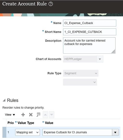

Create an Account Rule
Create an account rule to enable lines within carried interest journals to be entered as a credit in the cutback accounts for a joint venture. You associate the mapping set created in the preceding task to this account rule.
- In the Joint Venture Management functional area in FSM, select Show – All Tasks and then click the Manage Account Rules task.
- On Manage Account Rules: Joint Ventures, click Create.
- On Create Account Rule, complete these fields:
- Name.
- Short Name.
- Description.
- Chart of Accounts. Select the chart of accounts of the primary ledger of your joint venture.
- Rule Type. Select Segment from the drop-down list.
- For the chart of accounts that you selected, select the natural account segment value from the drop-down list.
- In the Rules area, click Add and specify the following values in the first
row:
- Value Type. Select Mapping Set.
- Value. Select the mapping set that you created in the preceding task.
Click Save and Close.
The following image shows an example of a new account rule that’s defined with a mapping set named Expense Cutback for CI Journals. The rule type for the account rule is Segment, which enables it to derive the value for the HEPPAccount segment in the HEPPLedger chart of accounts.
