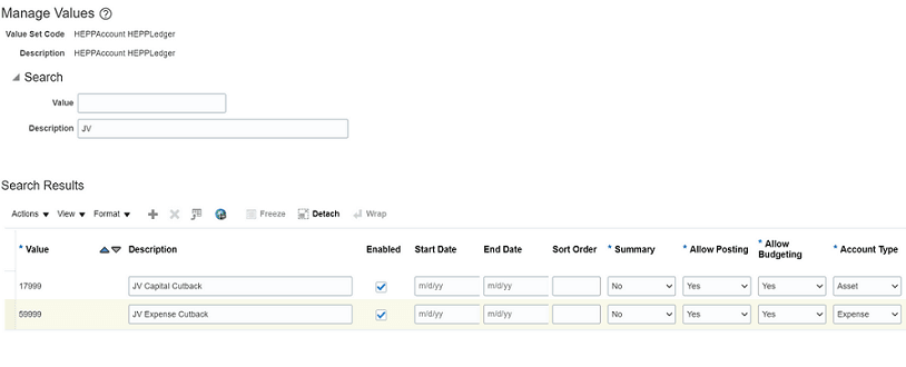

You need to identify the managing partner’s cutback accounts for crediting expense amounts from internal transfer journals.
Make sure that the cutback accounts are not part of the range of account values that are identified as distributable in the distributable segment values for the joint venture. This prevents lines from internal transfer journals from being identified as joint venture transactions for distribution.
The following image shows an example of two cutback accounts for a joint venture on the Manage Values page. It shows a JV Capital Cutback account with an Asset account type and a JV Expense Cutback account with an Expense account type.
This image is described in surrounding text.

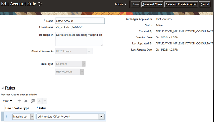

    The following image shows an example of a new account rule that’s defined with a mapping set.
    In this example, the account rule is created for and associated with a mapping set named Joint Venture Offset Account. The rule type for the account rule is Segment, which enables it to derive the value for the HEPPAccount segment in the HEPPLedger chart of accounts.

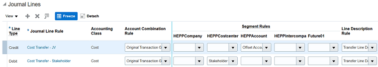

  6. On Edit Subledger Journal Entry Rule Set, access the Journal Lines area and highlight the Credit row for deriving cutback accounts.
    The columns in the Segment Rules represent the segments in the primary ledger for identifying the accounts that contain the original joint venture transactions.
  7. In the column representing the natural account segment of the chart of accounts, select the account rule that you set up in the preceding task.
    The account rule contains the mapping set that's used to enter internal transfer journal amounts into the appropriate cutback accounts.
    The following example shows a Credit journal line rule, in which the HEPPAccount column represents the natural account segment of the chart of accounts. An account rule named Offset Account was selected for the HEPPAccount.
    The example shows a Debit journal line rule, which was not modified because by default, it’s set up to use the cost center of the stakeholder to debit internal transfer amounts to the stakeholder accounts.
