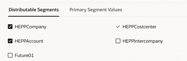

The segment associated with the primary segment label specified in the Joint Venture System Options is the primary segment. It’s selected by default and can’t be deselected. If the primary segment is a cost center, it might not be named "Cost Center." But you can tell that it's the primary segment because it's selected and grayed out.
 -  Select each segment that contains the accounts that you want to identify as
                distributable. You must select at least one other segment in addition to the primary
                    segment.
The following image shows an example of other segments named HEPPCompany and HEPPAccount that are selected in addition to the primary segment on the Distributable Segments tab.
