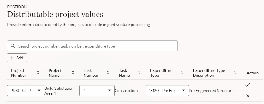

  4. In the first row provided, click the following fields to add a value or combination of values for the rule:
    • Project Number
    • Task Number
      To add a task, you must first select the project number the task is associated with.
    • Expenditure Type
      The following image shows an example of a row with a project number, task number, and an expenditure type.
    This image shows the Distributable Project Values tab.
