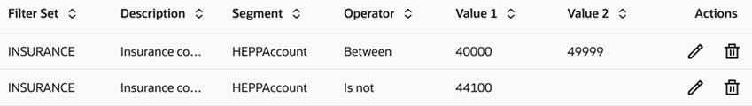

The joint venture accountant researches the joint venture setup and discovers that an account shouldn’t be included in the account set for identifying distributable accounts for the joint venture. The accountant corrects the setup issue so that no further transactions with the account information are distributed. The following image shows how the accountant corrected the issue in the account set. The accountant added a second filter to exclude the account that isn’t distributable.
This image shows a filter set with two filters, the purpose which is described in the surrounding text.
The image shows that in segment HEPPAccount, all accounts with values between 40000 and 49999, except for account value 44100, are set as distributable for the joint venture.
