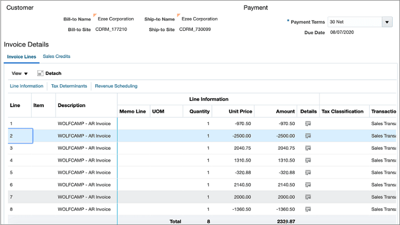

The following example also shows a joint venture receivables invoice that has both debit and credit invoice lines. The invoice amount is $2339.87. Due to a change in the ownership definition, you must reverse the joint venture distributions associated with invoice lines 2 and 7 and create a partial credit memo.
The original and reversed distributions for invoice lines 2 and 7 are as below:

The credit memo is created for $500 (2500-2000=500). Because this amount is a credit (negative in sign), it should increase the invoice amount instead of reducing it. The invoice amount after applying the credit memo is $2839.87 {2339.87-(-500)=2839.87}.
