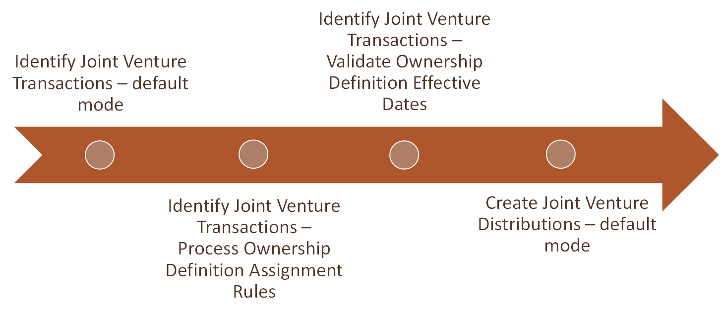

The following image shows the flow of running these processes:
This image shows the workflow to identify joint venture transactions, apply ownership definition assignment rules to transactions, validate ownership definition effective dates, and create distributions.
