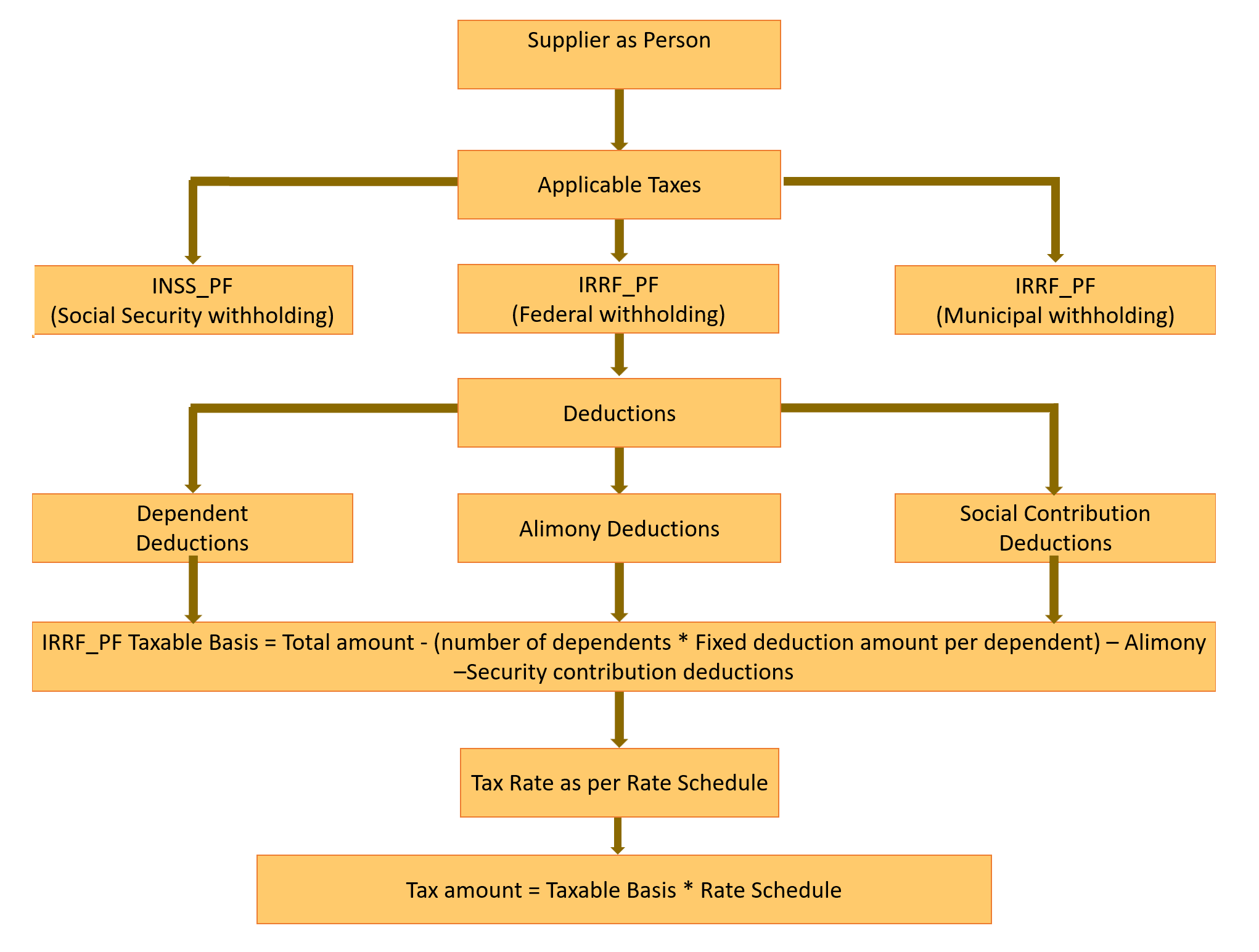

Deductions
In Brazil, dependent deductions are applicable during the withholding tax calculation for a supplier as a person providing services.
A deduction reduces the taxable base amount during the withholding tax calculation process.
Deductions applied to the IRRF_PF taxable basis include:
- Deductions for Dependents:
Number of dependents is multiplied by the fixed amount specified by tax authorities. For example, if the supplier has three dependents, 3 * 150.69 BRL = BRL 452.07 is deducted from the IRRF_PF withholding taxable basis.
- Deductions for Alimony:
Amount paid in the previous month is deducted from the IRRF_PF withholding taxable basis.
- Deductions for Social Security Contributions:
This image shows the process flow:

Tax Determination Process
In Brazil, IRRF_PF tax is calculated at the time of payment as follows:
IRRF_PF taxable basis = Total amount – Social security contribution deduction
Here is the IRRF_PF Tax Computation:
| Total invoice amount | 2600 BRL |
| Number of dependents | 3 |
| Fixed deduction amount per dependent | 150.69 BRL |
| IRRF_PF taxable basis | 2600- (3*150.69) = 2147.93 BRL |
| IRRF_PF tax amount as per rate schedule | 48.65 BRL |
