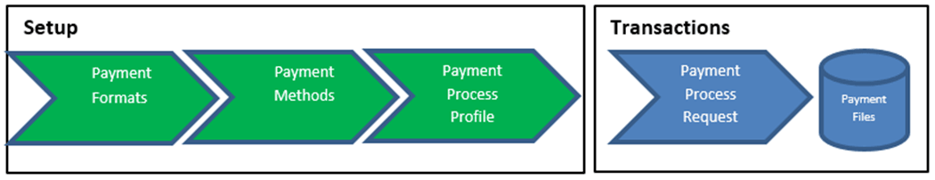

Configuring and Generating Electronic Payment Files
The Create and Extract Brazil Electronic Payment Files process is composed of a onetime configuration that provides all the required configuration data. You can run the Payment Process Request process to create payment files.
This image outlines the overall steps to generate electronic payment files:This image lists the steps to generate electronic payment files
The main configuration steps to configure and generate electronic payment files for Brazil are as follows:
  • Payment formats for Brazil
  • Payment methods for Brazil
  • Payment process profile
    Once the configuration is done, the Submit Payment Process Request job can be executed.

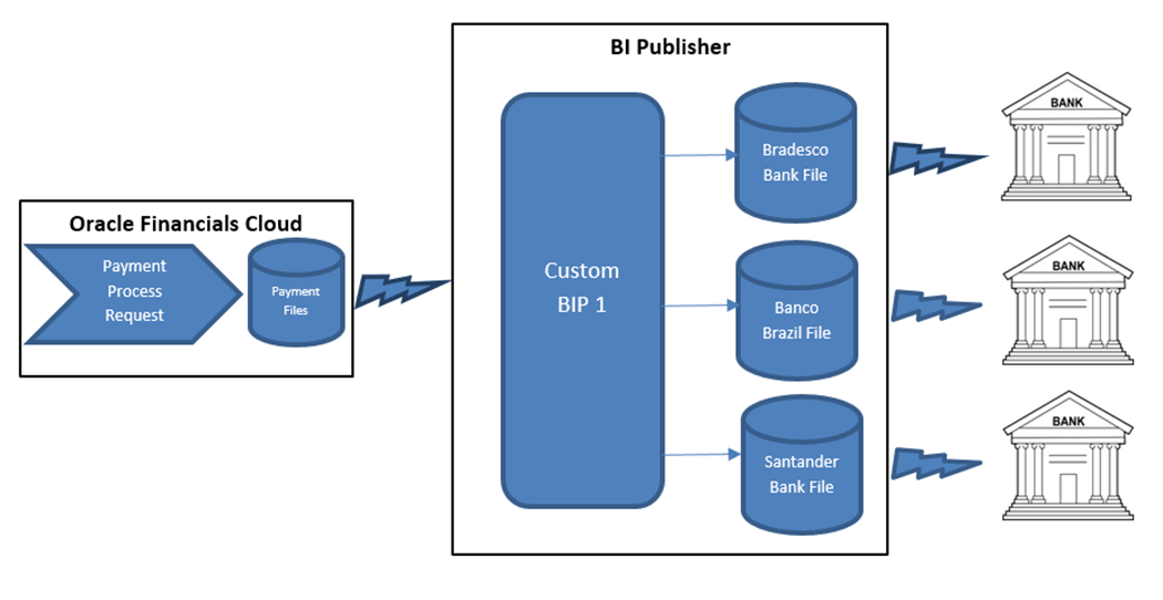

Integration - Creating Electronic Payment Files to Payer Bank Specific Formats
Oracle Financials Cloud provides an out-of-the-box payment file extract to export the payments from Oracle Cloud to the on premises financial system. For additional bank specific files formats, the implementation team must devise a strategy and build the export file using the Business Intelligence Publisher (BI Publisher) based on payments that are created. The following figure illustrates this flow:
To create user-defined BI Publisher reports that support bank specific formats, follow these steps:
  1. Sign in to BI Publisher Enterprise.
  2. Navigate to your report in the catalog.
  3. Click More to see all options.
  4. Click Customize.
    BI Publisher creates a copy of the report in the Custom folder, after the identical folder hierarchy and opens the report copy in the report editor.
  5. Create a user-defined layout for this report and save it.
    You can use the List View to:
    • define properties of the layout
    • Enable the custom layout as the default for this report
    • Inactivate the original layouts so your users no longer see them.
    For more information on setting the layout properties, see Configuring the Layout Settings Using the List View in the Oracle Fusion Middleware Report Designer’s Guide for Oracle Business Intelligence Publisher guide at http://docs.oracle.com.
  6. Apply security to the custom report.
BI Publisher creates an identical folder hierarchy for the user-defined copy of the report. The catalog permissions present on the original folders and report are not copied to the user-defined report or the folder hierarchy. You must manually reapply the catalog permissions to secure the user-defined report identically to the original report.
