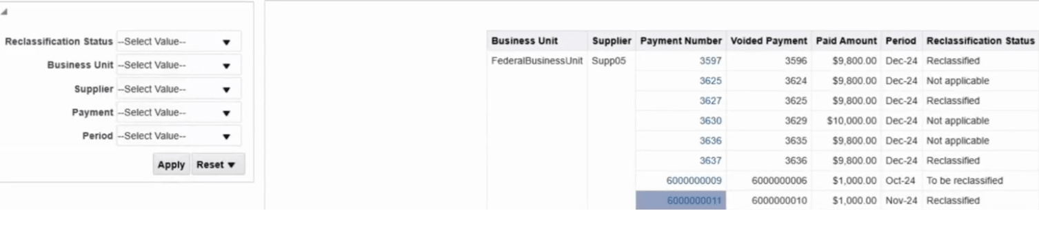

    Here’s an example of the summary view of the CTA Payables Reclassifications Report output:
    This image shows the summary view of the CTA Payables Reclassifications Report.
    The following table describes the fields reported in the summary view of the report:
    Field Description
    Business unit The business unit associated with the invoices and the payment.
    Supplier The supplier associated with the invoices and the payment.
    Payment Number The payment number of the reclassification payment.
    Voided Payment The voided payment number for the payment.
    Paid Amount The amount paid for the payment.
    Period The accounting period associated with the payment.
    Reclassification Status The reclassification status of the payment.

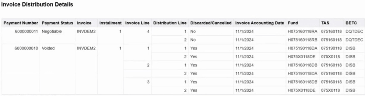

  6. To drill down to view the payment and invoice details for a reclassification payment, click the Payment Number link.
    Here’s an example of the detail view of the CTA Payables Reclassifications Report output:
    This image shows the detail view of the CTA Payables Reclassifications Report.
  7. The following table describes the fields reported in the detail view of the report:
    Field Description
    Payment Status The payment status of the reclassification payment, for example, Voided or Negotiable.
    Invoice The invoice number for the new or voided payment.
    Installment The installment number of the invoice for which payment has been made.
    Invoice Line The invoice line number for the new or voided payment.
    Distribution Line The distribution line number for the new or voided payment.
    Discarded/Canceled Indicates whether the invoice line is canceled or discarded. Yes indicates that the invoice line is canceled or discarded.
    Invoice Accounting Date The accounting date for the invoice associated with the payment.
    Fund The fund for the new or voided payment. This is derived from the invoice distribution account code combination.
    TAS The Treasury Account Symbol (TAS) associated with the fund for the new or voided payment.
    BETC The payment BETC associated with the invoice line.
