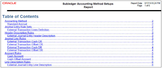

Overview
You can use the Subledger Accounting Methods Setup Report to view the accounting setups for a subledger application and accounting method.
Here are some screenshots of the Subledger Accounting Methods Setups Report.
         Key Insights
You can filter the report to view accounting setups for a particular event class and event type within the accounting method.
This report is useful to view the complete setup done for an accounting method as well as for audit purposes.

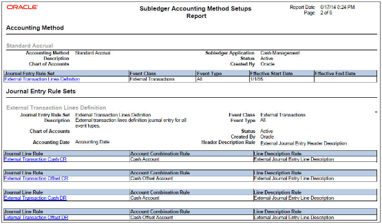

These are some details you can view in the Subledger Accounting Methods Setups Report:
Accounting Method
Journal Entry Rule Sets

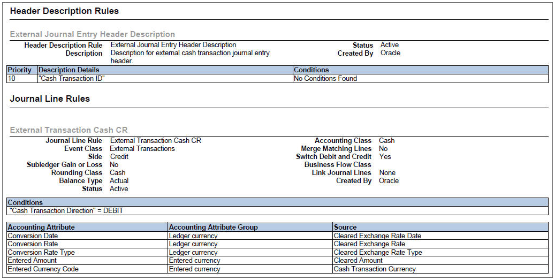

Header Description Rules
Journal Line Rules

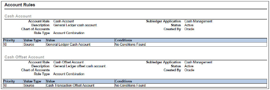

Account Rules
Line Description Rules
