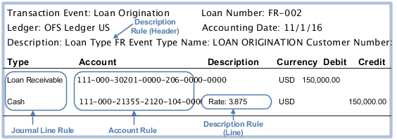

Journal Entry in Source System
This figure illustrates a journal entry.

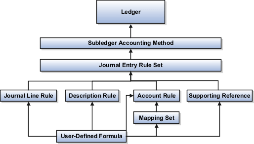

Accounting Rule Configuration in Accounting Hub
This image illustrates the subledger flow as detailed in the Manage Accounting Rules topics.
