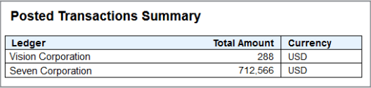

Posted Transactions Summary
This section shows a summary of the posted balances by ledger. Only the default user or role receives this summary. If no accounting transactions were successfully posted for any ledger after an accounting automation run, a message appears in place of this section.
Here's an example of a posting summary. A total of 288 US dollars was posted to the Vision Corporation ledger and 712, 566 US dollars was posted to the Seven Corporation ledger.
Here's more information about each column shown in the example.

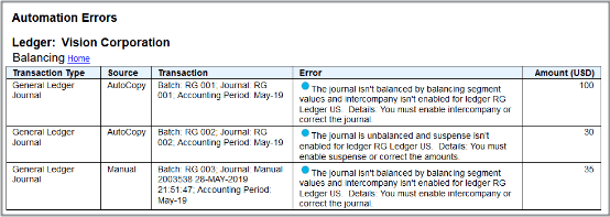

Automation Errors Summary
This section shows a summary of errors by ledger, source, and error category. The default user and users (or roles) assigned to the error category with the errors, receive this summary.
Here's an example. The Vision Corporation ledger has 3 transactions totaling 165 US dollars with balancing errors. All the errors were new for the latest accounting automation run, so the error count of 3 appears in the New column. The errors occurred in both the AutoCopy and Manual journal sources. Maria Smith was notified of the error in the AutoCopy source and Michael Taylor was notified of the error in the Manual source.
Column |
Description |
Ledger |
Ledger (primary, secondary, or reporting currency) of the transaction. Is blank if no ledger is associated with the transaction, such as daily rates import errors. |
Error Category |
Error category associated with the error. |
Total Amount |
Sum of the accounted amounts that couldn't be processed due to the error category for the ledger. |
Currency |
Ledger currency. |
Number of Errors - Total |
Count of the transactions that have errors. Links to the error details section of the email notification. |
Number of Errors - New |
Count of the transactions that have errors appearing for the first time in the latest accounting automation run. Links to the error details section of the email notification. |
Users Notified |
Users who were notified of the errors, excluding the default user who's always notified. Is blank if no users were set up to receive email notifications for the respective ledger, source, and error category. |

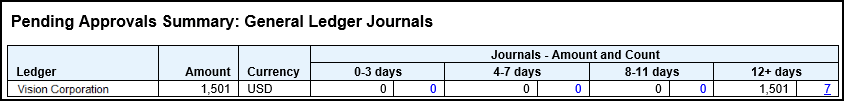

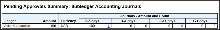

Pending Approvals Summary
- Pending Approvals Summary: General Ledger Journals
- Pending Approvals Summary: Subledger Accounting Journals
These sections show a summary of the General Ledger and Subledger Accounting journal batches, by aging bucket, that require approval, are in the process of being approved, or that were rejected. The default user and the users (or roles) assigned the Approval error category, receive this summary.
Here's an example of the General Ledger Journals summary. The Vision Corporation ledger has 7 General Ledger journal batches totaling 1,501 US dollars that have been pending approval for more than 12 days.
Here's an example of the Subledger Accounting Journals summary. The Vision Corporation ledger has 1 Subledger Accounting journal batch totaling 100 US dollars that’s been pending approval from 0 to 3 days.
Column |
Description |
Ledger |
Ledger (primary, secondary, or reporting currency) of the journal batch. |
Amount |
Sum of the journal batches that are in the approval flow. |
Currency |
Ledger currency. |
Journals Amount |
Total amount of journal batches pending approval broken down into the following aging buckets since the last approval action: 0 - 3 days, 4 - 7 days, 8 - 11 days, more than 12 days. |
Journals Count |
Number of journal batches pending approval broken down into the following aging buckets since the last approval action: 0 - 3 days, 4 - 7 days, 8 - 11 days, more than 12 days. Links to the Pending Approvals Details section of the email notification. |
Automation Errors Details
This section shows the detailed transactions or journals for the errors reported in the Automation Errors Summary section.
Column |
Description |
Transaction Type |
Identifies the source of the error, which includes:
Source |
Journal source of the transaction. |
Transaction |
Object of the transaction and identifying information. For example, the Subledger Transaction type for a Payables transaction displays the application, party name, party site name, invoice number, date, and amount. |
Error |
Information about the error that occurred, including suggested corrective actions in some cases. Errors appearing for the first time in the latest automation run are prefixed with a dot icon. |
Amount (Currency) |
Total of the accounted debits for the transaction. |

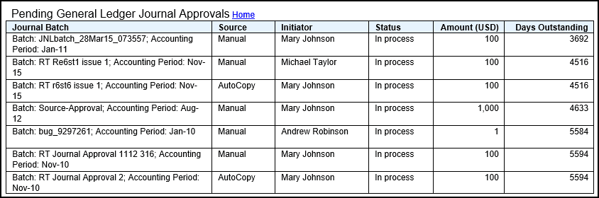

- Pending General Ledger Journal Approvals
- Pending Subledger Accounting Journal Approvals
These sections provide the details for the Pending Approvals Summary sections.
Here's an example of the General Ledger journal batches in the process of being approved. Various users initiated the approvals and the batches have been pending approval for many days.
Here's an example of the Subledger Accounting Journal batch that’s in the process of being approved.
Column |
Description |
Journal Batch or Subledger Journal |
Name of the journal batch. |
Source |
Source of the journal batch. |
Initiator |
User who requested the approval. |
Status |
Approval status of the batch. |
Amount (Currency) |
Journal batch amount in the ledger currency. |
Days Outstanding |
Number of days since the last approval action. |
