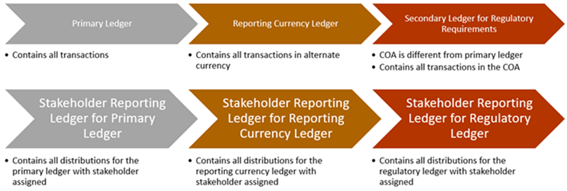

You must set up a separate stakeholder reporting ledger for each of the ledgers that you need to create financial reports by stakeholder. You might set up one for the primary ledger of the joint venture and additional ones for currency ledgers or any secondary ledgers associated with the primary ledger.
The following illustration shows an example of a primary ledger and its associated reporting currency ledger and secondary ledger for regulatory requirements. Below each ledger is the stakeholder reporting ledger for the ledger.
