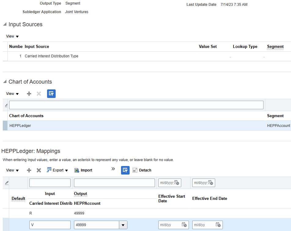

    The following image shows an example of a mapping set for overriding the account from the source transactions for the revenue distribution types. The purpose of the mapping set is to replace the natural account segment on the transaction with the cutback account.
    This image shows and example of a mapping set overriding the account from the source transactions for the revenue distribution type, the details of which are described in surrounding text.
    As shown in the example, specify these values in your mapping set:
    • Output Type. Select Segment.
      Note: When you access Create Mapping Sets from the Joint Venture Management functional area, Joint Ventures is selected by default for the subledger application. It can’t be changed.
    • Input Source. Search for and select Carried Interest Distribution Type, the one that’s associated with the Carried Interest Revenue event class.
    • Chart of Accounts. Select the chart of accounts associated with the primary ledger of the joint venture, which is HEPPLedger in this example.
    • Mappings. Add a row with the following values to map the revenue transaction type from carried interest journals to the cutback account:
      • Input. For Carried Interest Distribution Type, enter R for Revenue.
      • Output. For the natural account segment, select the cutback account. In this example, the natural account segment is HEPPAccount and the cutback account is 49999.
      Also, as shown in the preceding example, if you’re using manual revenue joint venture source transactions, you’ll need to add a row to map distribution type V to the cutback account.
