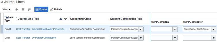

Example of Subledger Accounting Rules to Override the Account from the Partner Contribution Line
If distributed costs for stakeholders are covered by partner contributions, internal transfer journals include the following additional journal lines to account for the partner contribution amount:
  • A credit to the stakeholder’s partner contribution accounts
  • A debit to the joint venture’s partner contribution accounts
To enable the accounting of these entries, in your copy of the Cost Transfer journal entry rule set, you must modify both of the following predefined journal line rules:
  • Cost Transfer - Internal Stakeholder Partner Contributions
    Click in the column representing the cost center segment and select Stakeholder Cost Center, which is a predefined account rule used to retrieve the stakeholder’s cost center. The cost center value is used in deriving the account for the credit entry.
    Note: Although the default name refers to internal stakeholders, this rule can apply to both internal and external stakeholders. If you prefer, you can rename this rule to avoid confusion.
  • Cost Transfer - JV Partner Contribution, which is for the debit entry
    Click in the column representing the cost center segment and select the blank value. Make sure there’s no value selected for the cost center segment.
    For this journal line rule, there’s an account rule named Partner Contribution Account assigned by default to the Account Combination Rule. This account rule is used to retrieve the partner contribution account for the debit entry. The partner contribution account is specified by joint venture accountants when they create partner contributions for stakeholders.
This image shows an example of the predefined journal line rules modified as described:
This image shows an example of the predefined journal line rules as described in surrounding text.
