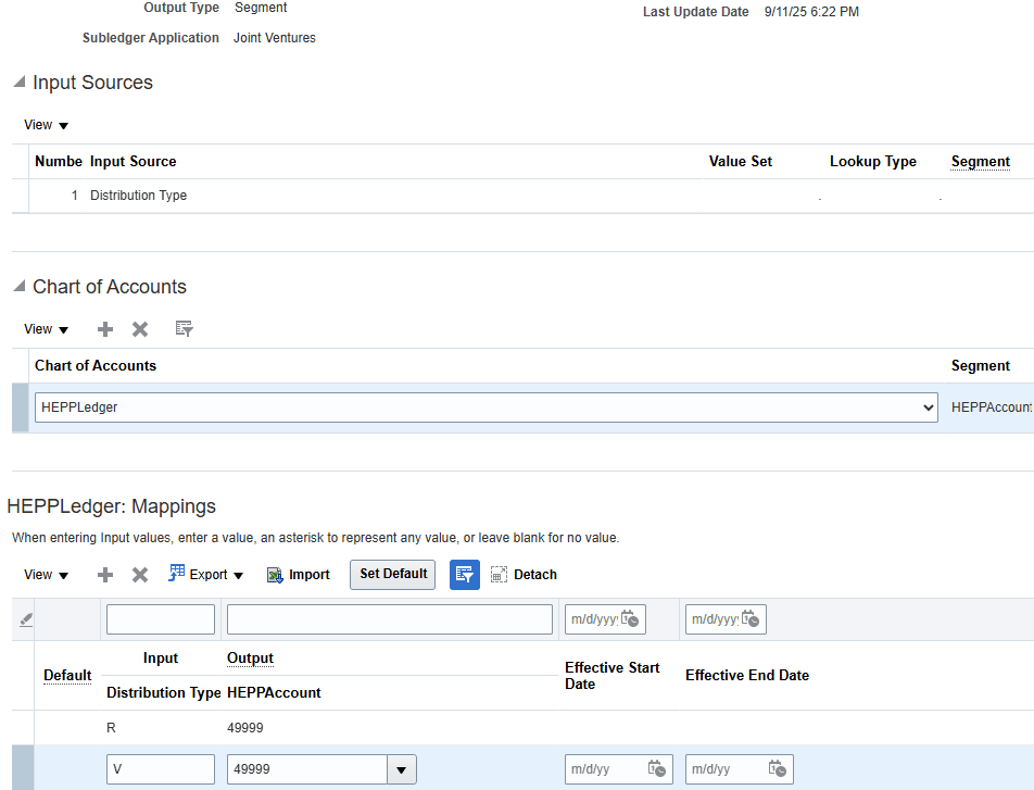

The following image shows an example of a mapping set for overriding the account from the source transactions for the revenue distribution types. The purpose of the mapping set is to replace the natural account segment on the transaction with the cutback account.
This image shows a mapping set for overriding the account from the source transactions for the revenue distribution types. The details in the image are described in surrounding text.
As shown in the example, specify these values in your mapping set:
  • Output Type. Select Segment.
    Note: When you access Create Mapping Sets from the Joint Venture Management functional area, Joint Ventures is selected by default for the subledger application. It can’t be changed.
  • Input Source. Search for and select Distribution Type, the one that’s associated with the Revenue Transfer event class.
  • Chart of Accounts. Select the chart of accounts associated with the primary ledger of the joint venture, which is HEPPLedger in this example.
  • Mappings. Add a row to map the revenue distribution type R to the cutback account, which is 49999 in the example. Also, if you’re using manual revenue joint venture source transactions, you’ll need to add a row to map distribution type V to a cutback account.
    In the setup shown in this example, distributions with a value of R will output a value of 49999 for the HEPPAccount segment.
