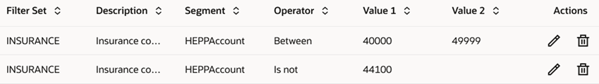

The joint venture accountant researches the joint venture setup and discovers that an account shouldn’t be included in the account set for identifying distributable accounts for the joint venture. The accountant corrects the setup issue so that no further transactions with the account information are distributed. The following image shows how the accountant corrected the issue in the account set. The accountant added a second filter to exclude the account that isn’t distributable.
The image shows that in segment HEPPAccount, all accounts with values between 40000 and 49999, except for account value 44100, are set as distributable for the joint venture.

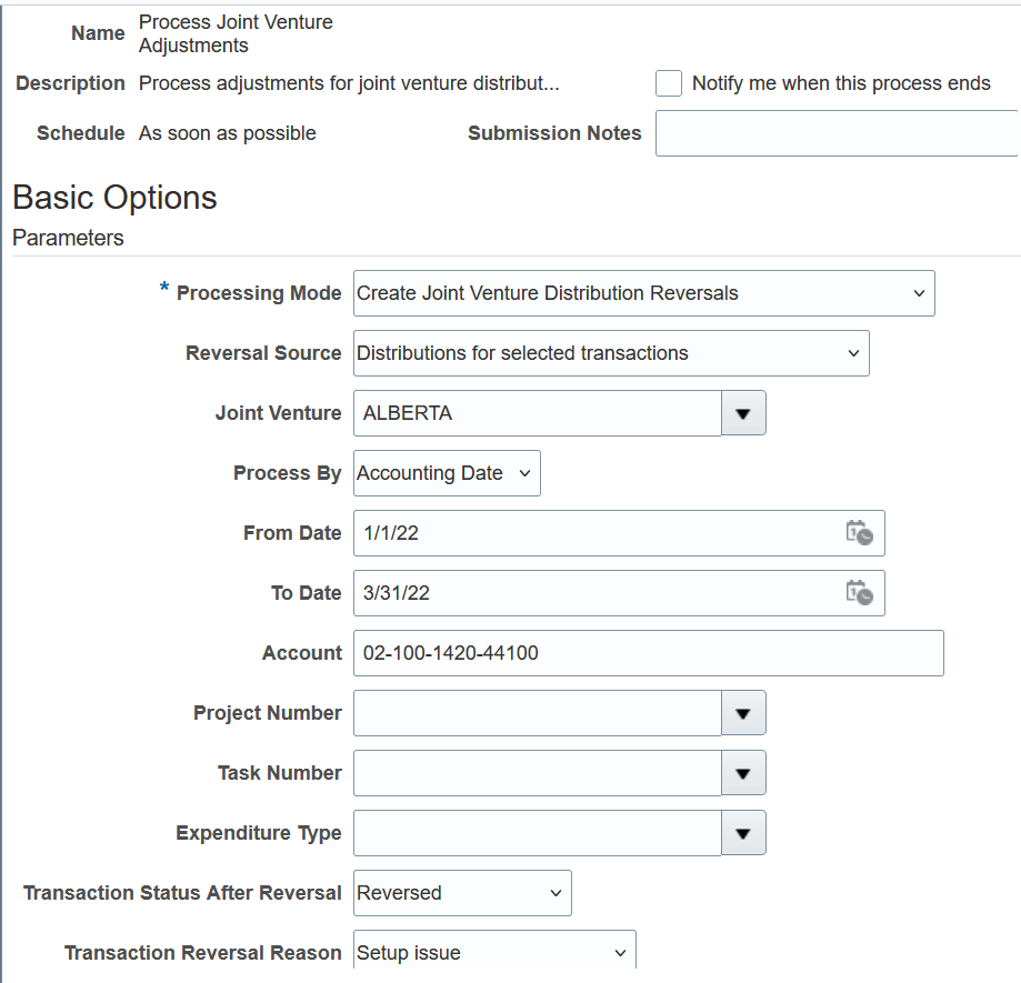

Next, the joint venture accountant runs the adjustments process to reverse the distributions that were billed in error. In the “Process Joint Venture Adjustments” process, the accountant completes the following parameters to identify the transactions whose distributions need to be reversed:
| Parameter | Value |
| Processing Mode | Create Joint Venture Distribution Reversals |
| Reversal Source | Distributions for selected transactions |
| Joint Venture | Alberta |
| Process By | Accounting Date |
| From Date | 01/01/2022 |
| To Date | 03/31/2022 |
| Account | 02-100-1420-44100 |
| Transaction Status After Reversal | Reversed |
| Transaction Reversal Reason | Setup issue |
The following image shows the completed parameters in the adjustments process:
