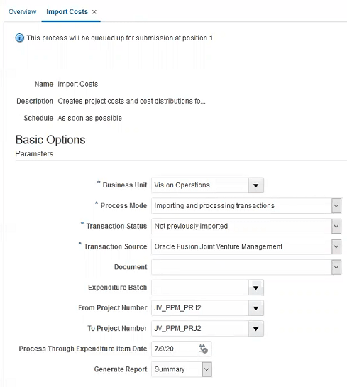

  3. Complete these fields:
    • Business Unit
    • Process Mode. Select “Importing and processing transactions.”
    • Transaction Status. Select “Not previously imported.”
    • Transaction Source. Select “Oracle Fusion Joint Venture Management.”
      This is the same value that the joint venture accountant entered for the transaction source when running the “Create Project Costing Adjustments” process.
    • From Project Number
    • To Project Number
      For the preceding From and To values, enter the project number or range of project numbers that you created cost adjustments for.
    • Process Through Expenditure Item Date
    This image shows the process page with the Import Costs process selected with a Process Mode of Importing and processing transactions. The columns and the values entered for each column are described in surrounding text.
  4. Click Submit.
