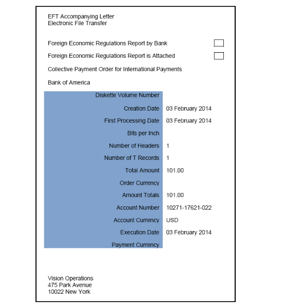

This figure illustrates an example of the Funds Capture Accompanying Letter.
