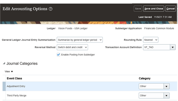

    6. Assigning the Transaction Account Definition to a Ledger
    For the transaction account definition rule to work, you must assign the transaction account definition to a ledger as shown in the following image.
    • The screenshot illustrates assigning a TAD to a ledger.
    • Navigate to the Setup: Financials > Intercompany>Manage Subledger Accounting Options page.
    • Search for the ledger.
    • Expand the ledger.
    • Select Financials Common Module and click the Edit Accounting Options icon.
    • Select the Transaction Account Definition you defined.
    • Select the Transaction Account Definition that you created earlier.
    • Save the updated accounting options.
    • Now the Transaction Account Definition is assigned to the ledger.

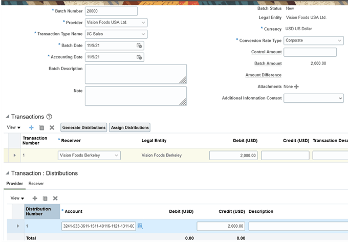

    7. Creating Transaction Account Definition Enabled Transactions
    Now, when we create transactions, the distributions are automatically created as illustrated in the following image.
    • The screenshot illustrates that when we create transactions, the distributions are automatically created.
    • Navigate to Intercompany Accounting > Transactions.
    • Click the Tasks Panel tab > Create Transactions.
    • Enter a batch number.
    • Select a provider, for example, Vision Foods USA Ltd.
    • In the Transactions section, click the Add Row icon.
    • Select the receiver organization and enter a debit amount. For example, $2000.
    • Select Receivables transaction type, for example, AR_TraType_08-NES for provider distribution to get assigned automatically.
    • Click Assign Distributions. This will automatically assign the provider distribution accounts.
    • Similarly, in order to assign distribution for receiver automatically select receivable transaction type, AR_TraType_22-NES and click assign distributions. This will automatically assign the receiver distribution accounts.
    • In the Transactions 1: Distributions region, click the Provider tab to check the provider distribution. Since the provider legal entity is associated with the ledger that has the transaction account definition assigned to it, the distribution is automatically generated.
    • Similarly, since the receiver legal entity is associated with the ledger that has the transaction account definition assigned to it, the distribution will be automatically generated.
