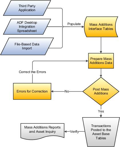

The following figure contains the flow of importing assets into Assets and posting them.
This flowchart illustrates the process of importing assets and posting them to Assets.
