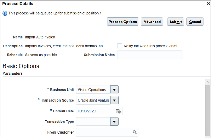

  4. In the Basic Options section, complete the following required fields:
    • Business Unit. Select your joint venture business unit from the drop-down list. The process will create credit memos for the reversed distributions associated with this business unit.
    • Transaction Source. Search for and select "Oracle Joint Ventures" from the drop-down list. This is the predefined transaction source for joint venture receivables invoice and credit memo. The process will select only those reversed records that are associated with this transaction source.
    • Default Date. This is the accounting date to apply to credit memos. You can’t run this process without entering a date in this field. However, this date will be ignored for joint venture credit memos and the accounting date that was entered in the process to send reversed cost distributions to create credit memos will be used instead. If you didn’t specify an accounting date in that process, the last day of the current open period will be used.
      This image shows the options of the Import AutoInvoice process, the details of which are described in the surrounding text.
  5. Optionally, specify values in the other fields to filter reversed joint venture distributions that you want to process.
