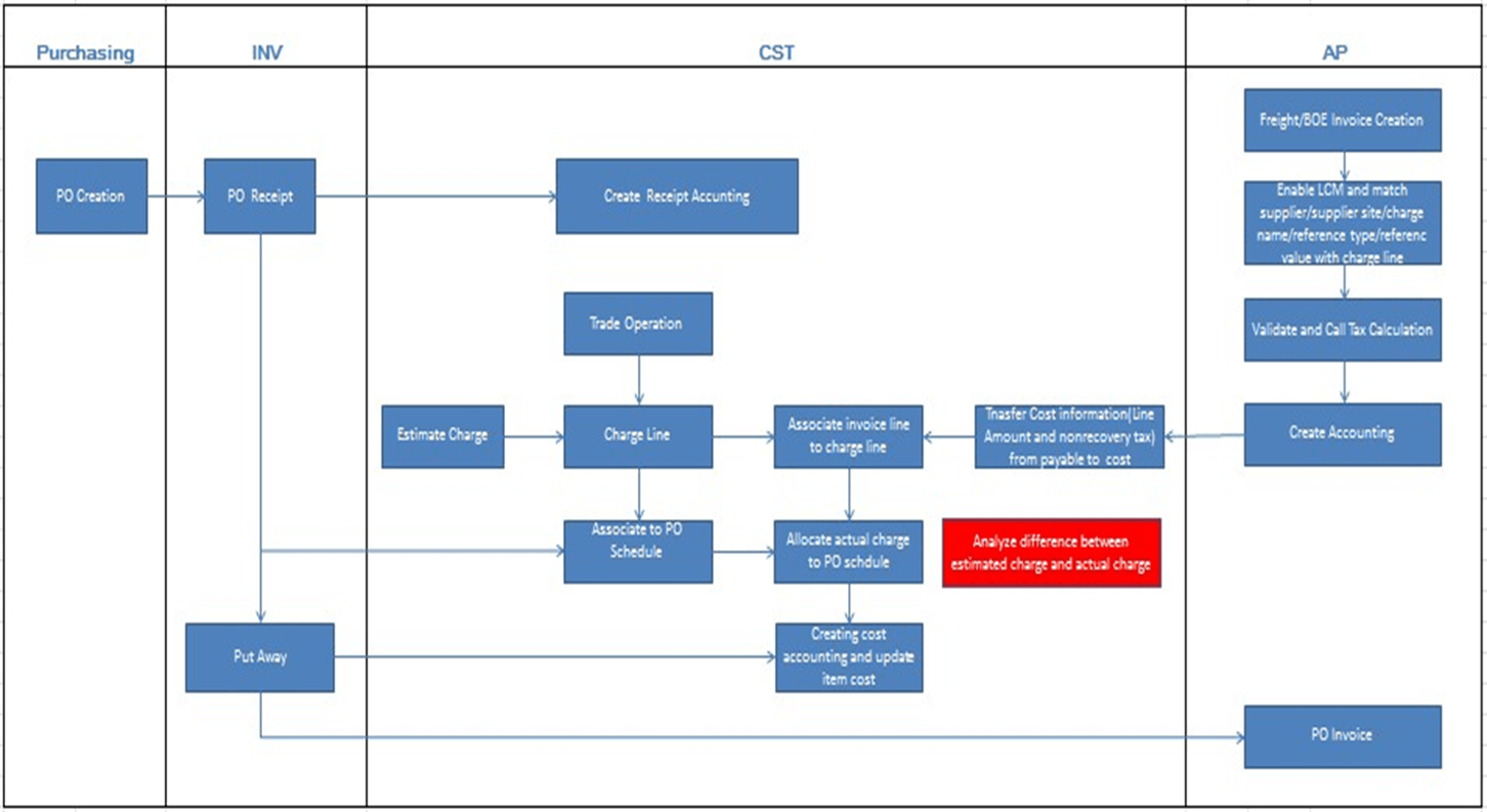

This image displays the work flow for this case study.
This image shows accounting the inbound customs charges and its cost allocation workflow.
