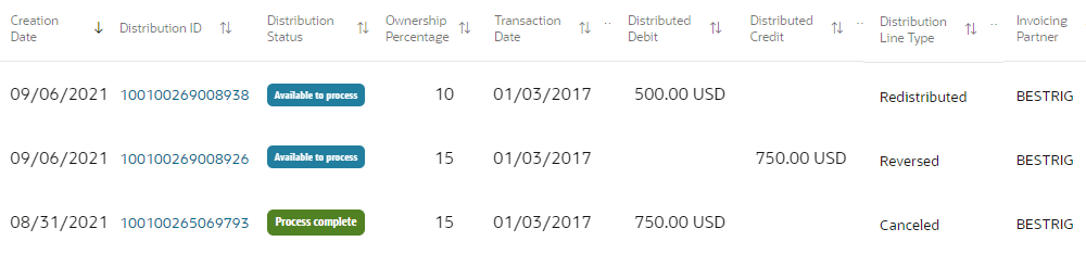

The following example shows a canceled, reversed, and redistributed distribution for a stakeholder named BESTRIG.
This image shows the Joint Venture Distributions page with canceled, reversed, and redistributed records, the details of which are described in the surrounding text.
In the example, the original distribution has a distributed debit of $750.00 and is marked as Canceled in the Distribution Line Type column. The reversed distribution created for the canceled line has a distributed credit of $750.00. The new distribution with the Redistributed distribution line type has a new debit amount of $500.00, which was calculated according to the stakeholder’s percentage in the new ownership definition.
