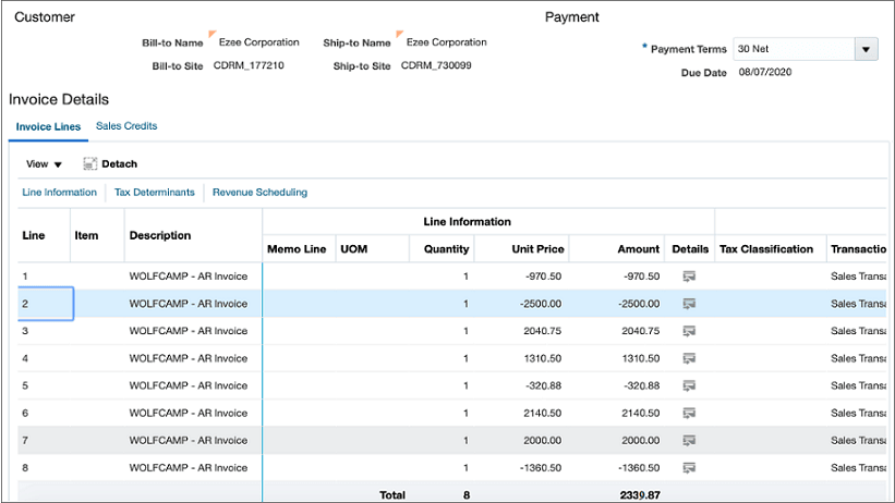

The following example also shows a joint venture Receivables invoice that has both debit and credit invoice lines. The invoice amount is $2339.87. Due to a change in the ownership definition, you must reverse the joint venture distributions associated with invoice lines 2 and 7 and create a partial credit memo.
This image shows the Invoice Details page of an invoice that has multiple credit and debit lines, the details of which are described in the surrounding text.

The credit memo is created for $500 (2500-2000=500). Because this amount is a credit (negative in sign), it should increase the invoice amount instead of reducing it. The invoice amount after applying the credit memo is $2839.87 {2339.87-(-500)=2839.87}.
You can create such a credit memo in Oracle Receivables only if the “Natural application only” checkbox is not activated for the joint venture credit memo transaction type. This checkbox is selected by default. With this default setting, Receivables only applies payment to a transaction that brings the balance close to or equal to zero. It won't create a credit memo such as the one in this example, but will issue an error instead.
