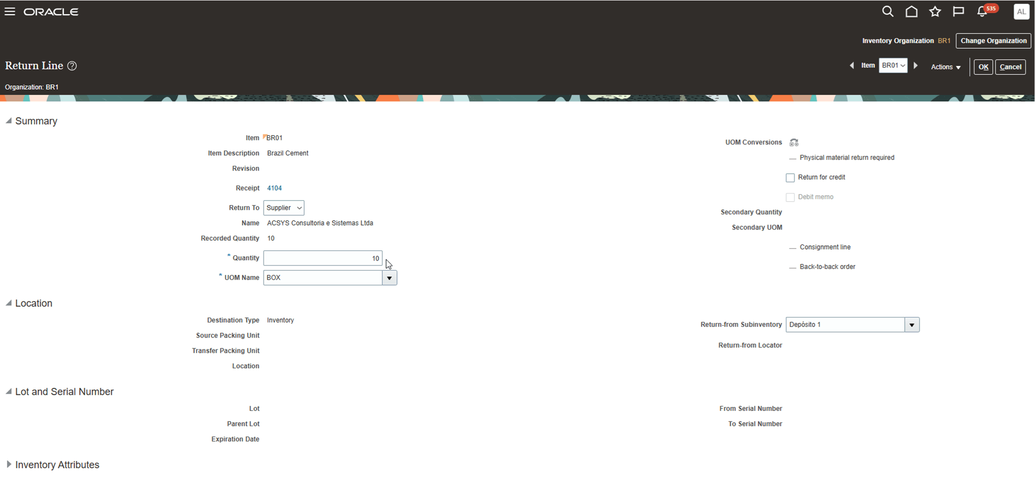

  4. On the Return Lines page, select View Details.
    This image shows return receipt details on the Return Line page.The image shows return receipt details on the Return Line page.
  5. Enter the quantity being returned.
