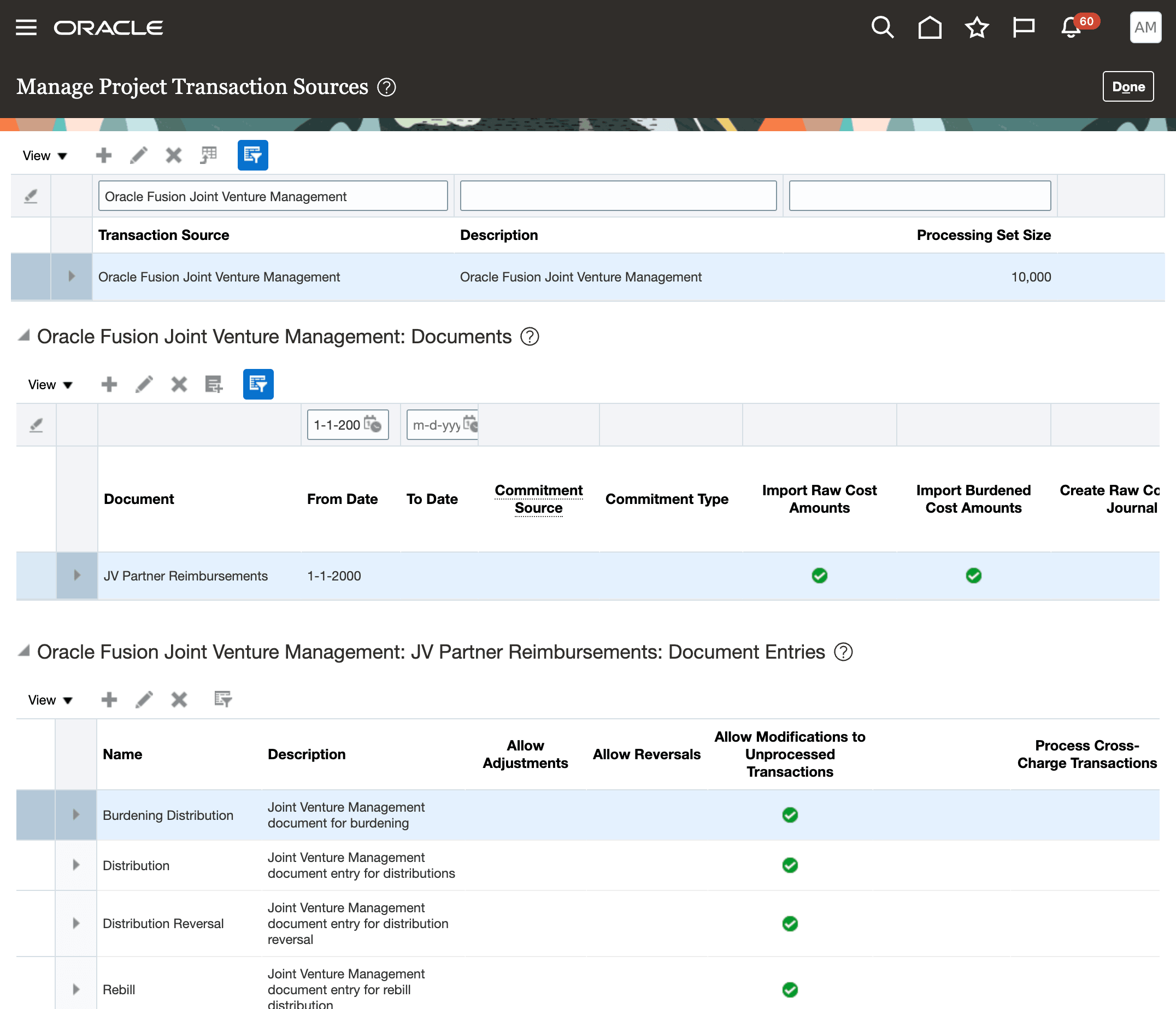

  5. Before you select Done, review your Oracle Fusion Joint Venture Management transaction source and verify that it’s configured correctly.
    The following image shows the sections on the Manage Project Transaction Sources page for the transaction source, document, and document entries that were created as described in the preceding steps. The first section displays the transaction source with a description and processing set size. The second section shows the document with a from date and check marks in the Import Raw Cost Amounts and Import Burdened Cost Amounts columns. The third section includes rows for the following document entries: Burdening Distribution, Distribution, Distribution Reversal, and Rebill. Each entry includes a description and a check mark in the Allow Modifications to Unprocessed Transactions column.
    This image shows the completed Manage Project Transaction Sources page, the details of which are described in surrounding text.
