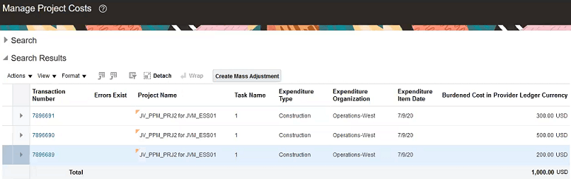

A project accountant imports project cost transactions from subledger accounting into Project Costing. In this example, three transactions for the Operations-West expenditure organization appear on the Manage Project Costs page, as shown in the following image.
This image shows the Manage Project Costs page with three records.

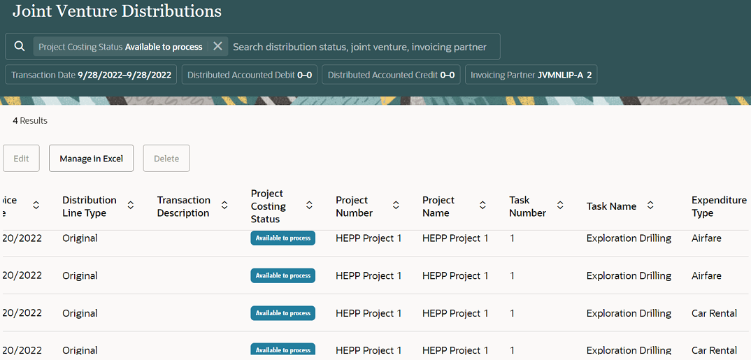

The following example shows 4 distributions in the Joint Venture Distributions work area that the process will create cost adjustments for. Notice that the Project Costing Status for these distributions is Available to Process.
This image shows the Joint Venture Distributions page with four records in the Available to process status.

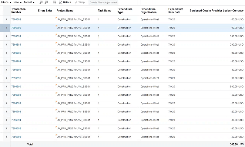

The following image shows an example of costs in Project Costing, with positive amounts for the original costs, negative amounts for the cost adjustments, and the resulting net cost of $500.
This image shows original cost transactions and cost adjustments in Project Costing and the calculated net amount.
