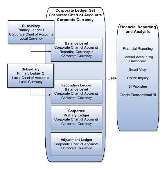

The following figure illustrates this scenario.
  • The two subsidiaries and the corporate ledger share the same calendar.
  • The first subsidiary uses the corporate chart of accounts and a local currency. The reporting currency functionality is used to record balances in the corporate currency.
  • The second subsidiary uses a local chart of accounts and a local currency. A secondary ledger is used to record balances in the corporate chart of accounts and the corporate currency.
  • The reporting currency, secondary ledger, corporate ledger, and adjustment ledger, are grouped into the corporate ledger set for consolidation and reporting.
  • The adjustment ledger is used to book consolidation adjustment entries, such as adjustments for intercompany and minority interest elimination.
This figure shows the Corporate Ledger Set with one corporate ledger, an adjustment ledger, and two subsidiary ledgers that were translated into the corporate currency for consolidation.
