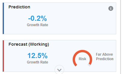

Use the Info Boxes to see details about each data series on the chart:
The risk gauge in the Info Box indicates the probability of a scenario occurring above or below the prediction.

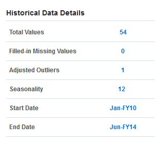

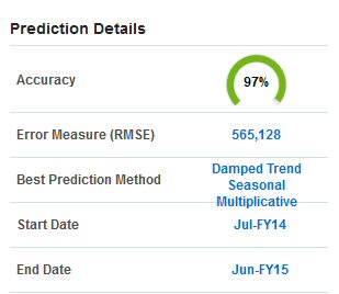

Click
(Details) to get more information about the prediction data or the historical data:
Use the tooltips to get insight about the detail information.

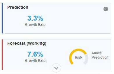

The Growth Rate makes it easy to quickly compare any two series.
The tooltips explain the comparison. For example, the growth rate statistic for the prediction indicates the year-over-year growth rate for the first year of future values compared to the last historical year.
