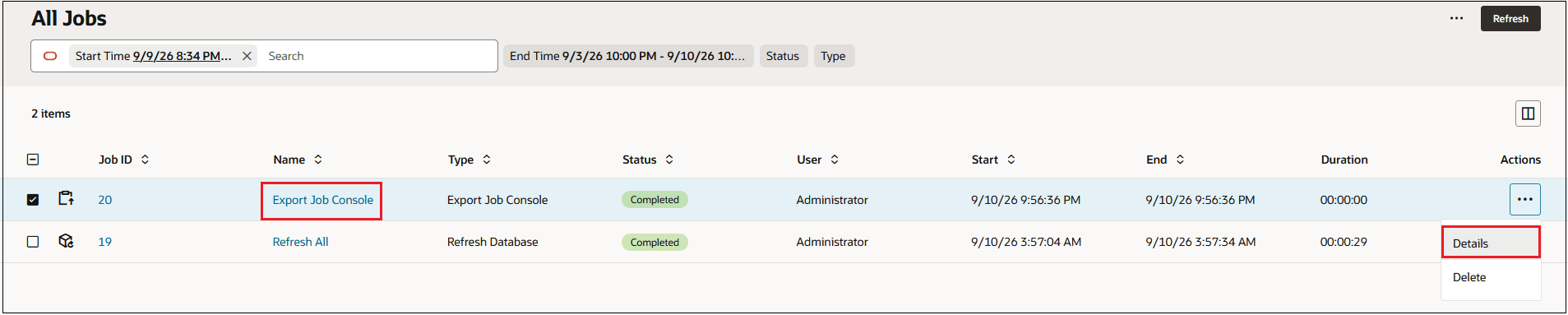

From the Jobs console, click the All Jobs tab.
Select the job(s) to export.
To export all the jobs in the Jobs console, click Export at the top right of the page.
To export a single job, click the checkbox next to a job to select it, and then click
at the top right of the page, and select
Export.

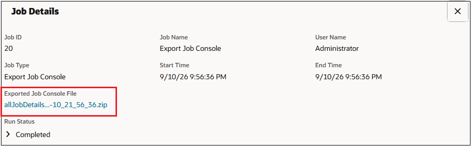

When the job status says "Complete", click the hyperlink for the Export Job Console job, or click
, and select Details.
On the Job Details page, click the hyperlink for the Exported Job Console zip file.
Click the downloaded zip file to open it.
The file is downloaded to your local machine in a file called
allJobDetails<date>.csv. -
Click the
allJobDetails<date>.csvfile to open it in Excel.
