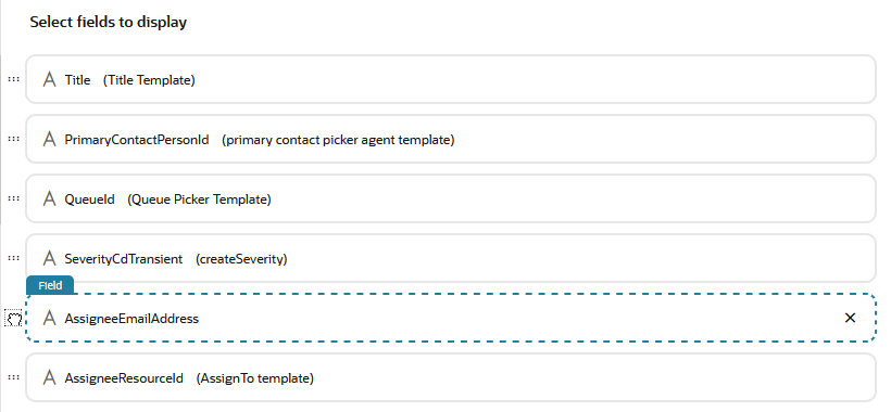

  5. To reorder fields, click the control beside the field, and drag the field to where you want it to go in the layout order.
    The following screen capture shows the control you use to drag and drop fields in the layout.
    A detail of the control used for moving fields..
  6. To hide a field either deselect the field in the field list, or hover in the field in the layout and click the X.
