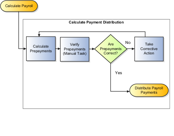

Calculate the distribution of payments and verify the prepayment calculations before you distribute payroll payments. This figure shows you the flow of the calculate payment distribution tasks.

Verify Prepayments
Use the Verify Prepayments manual task to review and verify prepayment results before generating payments. Verify prepayment results for individual records on the View Person Process Results page to ensure that the payee, payment method, and payment and deduction amounts are accurate.
Take Corrective Action
If you find problems, correct the underlying data and process the correction with one of these:
Retry the Calculate Prepayments process if it didn't complete successfully.
Roll back the prepayment results to restore the previous values and remove any record of the prepayment calculation results. You can only roll back the prepayments process if there were no payments.
Void the prepayments results to void the payment and then use the Make Payment action to reissue another payment.
