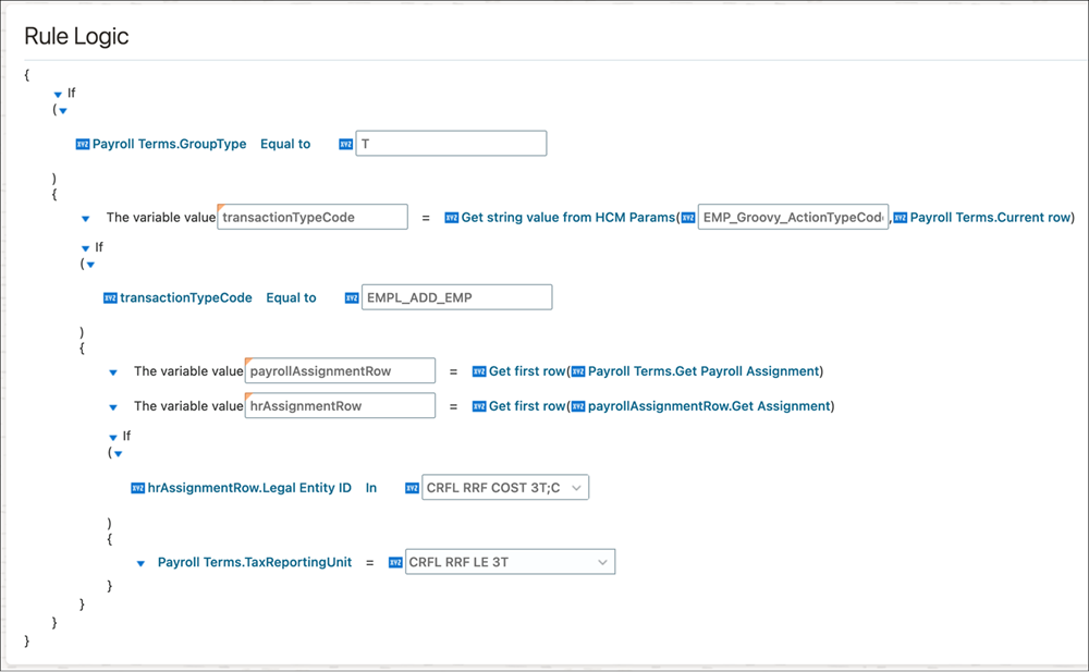

Autocomplete Rules for Tax Reference Unit
You can default the TRU from the HR assignment attributes, using the Payroll Terms business object. When you create rules:
Select Field Modification Rule Type in the Rule Type field.
Select Payroll Terms in the Business Object field.
Select Default Payroll Values Indicator in the Field field.
Autocomplete rules are supported in the following transactions:
Hire an Employee
Add contingent worker
Add Non Worker
Add Pending Worker
Add Assignment
Add Temp Assignment
Create Work Relationship
Add a Pending Worker
Create and Edit Offer
Local and Global Transfer

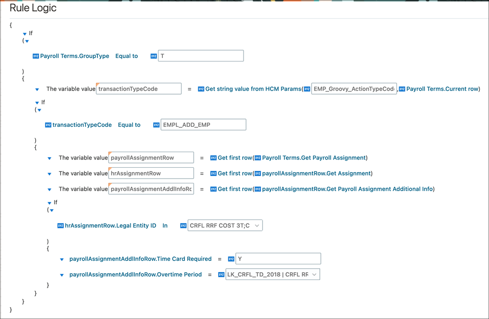

Here's some sample screenshots that illustrate the Autocomplete rule logic. The value
of the EMP_Groovy_ActionTypeCode HCM Params function must match the ActionTypeCode of
the respective flow (such as New Hire, Local and Global Transfer, Add Assignment, and so
on).
