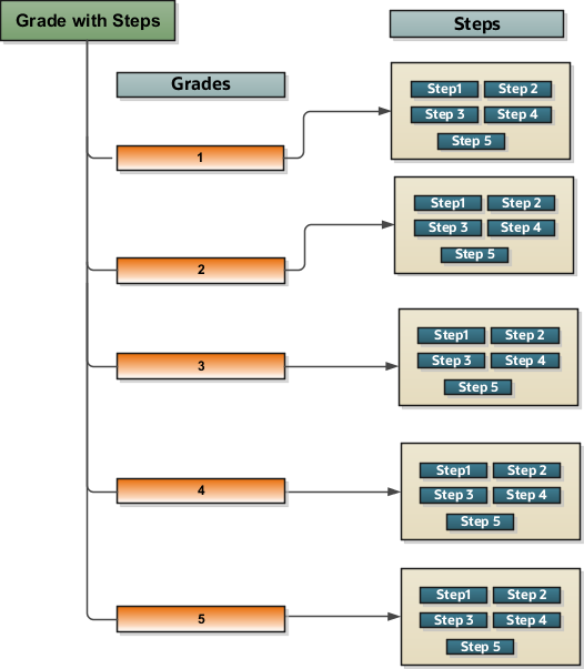

               Set up five different grades and add five steps for each grade. -
                     Use the Manage Grades task to set up the grades, 1 to 5.
                     On the Grade Steps page, add the five grade steps, Step 1 through Step 5, to each of the grades as shown in this illustration.

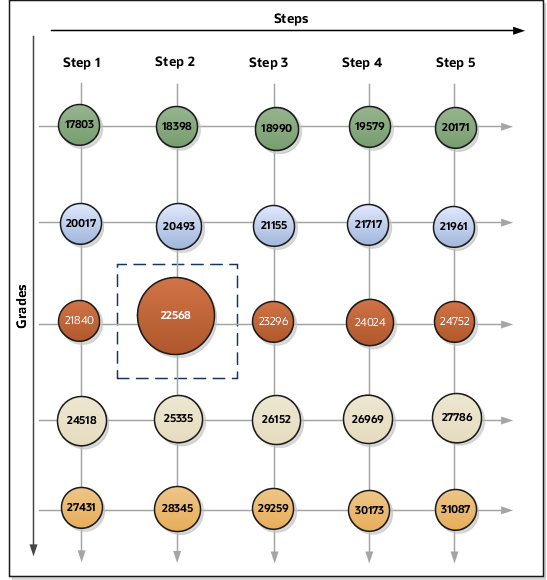

                     On the Grades and Steps page, add the grades with steps in the sequence in which your employees typically progress in your organization. Enter the sequence for the place of the grade on the grade ladder, with 1 being the lowest grade. The employee can move up till the grade 5.
 Grade Step 1 Step 2 Step 3 Step 4 Step 5 1 17803 18398 18990 19579 20171 2 20017 20493 21155 21717 21961 3 21840 22568 23296 24024 24752 4 24518 25335 26152 26969 27786 5 27431 28345 29259 30173 31087

Result: As shown in this illustration, the application returns a rate value of 22568.
