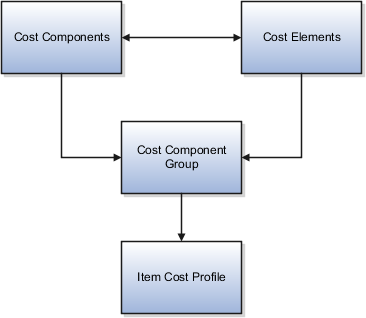

How Cost Components, Cost Elements, and Cost Component Groups Work Together
Cost components are user-defined or come from external sources, and are mapped to cost elements which the costing application uses to track the cost of items.
Use cost component groups to map cost components to cost elements, and to map source cost elements to destination cost elements when items are transferred from one inventory organization to another.
This figure illustrates the relationship between cost components, cost elements, cost component groups, and cost profiles.

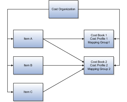

You have flexibility in how you map cost component groups to items:
               Different items in a cost organization and book combination can have the same or different cost component group mappings if they use different cost profiles.
               One item can have different cost component group mappings in different cost books.
               Several cost organizations can share the same cost component group mappings if they belong to the same set, or if they're defined the same way in different sets.
The following figure illustrates different mappings of cost component groups to items. That is, in a cost organization, Item A maps to two cost groups, and item B and Item C maps to only one cost group.
