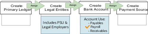

Payment sources identify your company bank accounts debited for payroll payments. You must associate at least one payment source to an organization payment method.
This validation occurs to ensure the bank account on the payment source are available for payroll payments:
Must be associated to a Payroll Statutory Unit (PSU). You must either assign a PSU legal entity to the bank account or assign a legal employer with a parent PSU to the bank account.
Must be enabled for payroll payments. You must select Payroll in the Account Use option for the bank account.
Must have active bank account. You must assign a bank account that's active at the time of the payroll payment.
You can use the same bank account in different payment sources in more than one organization payment method, as in this example.
