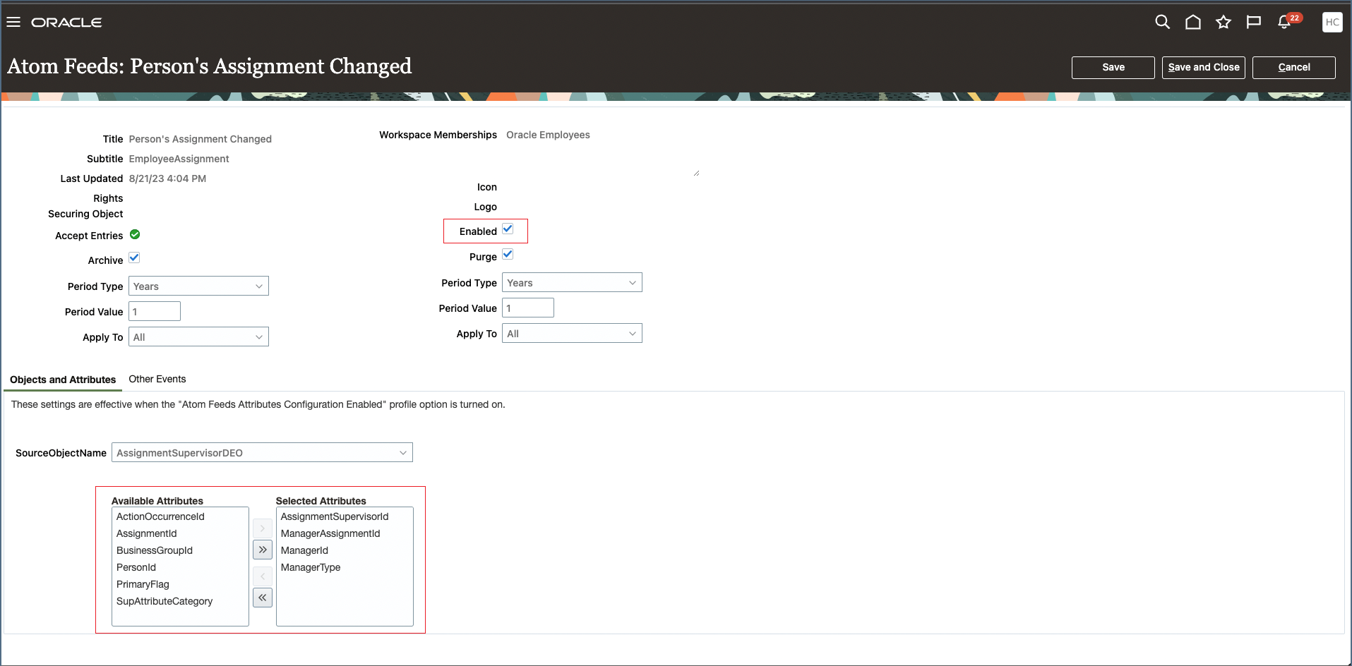

Configure Atom Feeds
To configure the Atom feeds:
- Go to the Manage HCM Atom Feeds task in the Setup and Maintenance work area.
- Select the feed that you want to configure.
- On the Atom Feeds page, select the business object from the SourceObjectName list to see the attributes for the object.
- To enable or disable the feed, select or deselect the Enabled check box.
- To enable or disable the attributes for the feed, select the attributes and use the Move button to move them to the Available Attributes or the Selected Attributes list.
- Click Save and Close to save your changes.

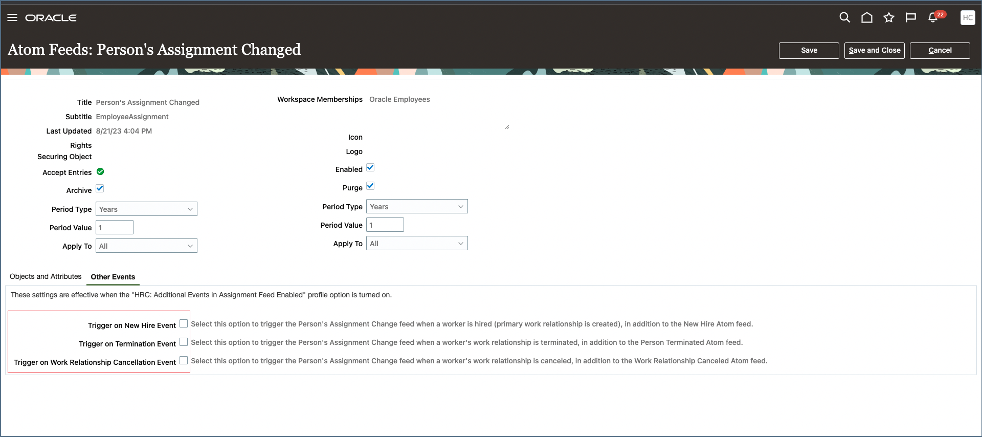

Configure the Employee Assignment Atom Feed
empassignment Atom feed to include assignment changes that are triggered by these work relationship-related events:
- New hire
- Termination
- Work relationship cancellation
Enabling work relationship-related events in the empassignment Atom feed eliminates the need to subscribe to work relationship-related feeds, depending on your specific integration requirements. Assignment attributes are available directly in the empassignment feed, without having to make additional REST calls from the work relationship feed entries.
For the changes to take effect, you need to set theORA_HRC_ATOM_OTHER_EVENTS_IN_ASG profile option to
Y.
To configure the empassignment Atom feed:
- Select the Person's Assignment Changed Atom feed.
- Click the Other Events tab.
- Review and select the events of your choice.
