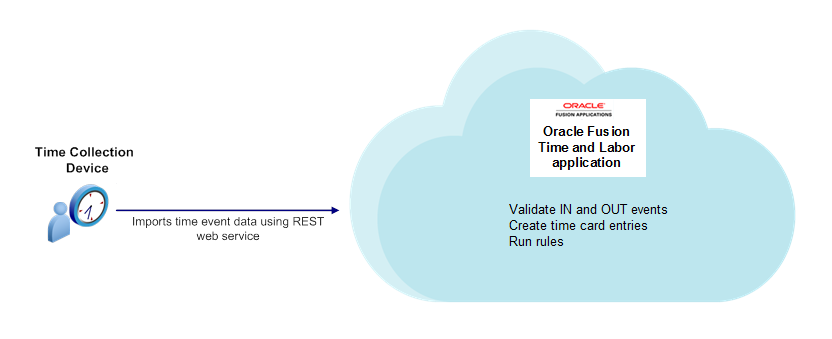

Manage In and Out Time Events
This use case describes the scenarios in which a worker records both In and Out events using an external time collection device.
Report Normal Shift Start and Stop Times
On Monday, the worker records In and Out time events without taking a meal break.
The following table shows the Time and Labor configuration that applies to this scenario.
| Configuration | Purpose |
| Time device event mappings | Maps the supplier device events to the corresponding application events. |
| Time device rule | Validates the time entry against the worker's schedule. |
| Time submission rule |
The following table describes the application processing actions that occur for the reported In and Out time events:
| Time Event | Application Processing |
| On Monday, the worker reports in at 8:00 AM. |
| The worker reports out at 5:00 PM. |
