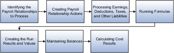

The main steps of the payroll run processing:
The calculation process:
Identifies the payroll relationships to process
Evaluates the assignment status of each identified payroll relationship to determine whether to include the assignment.
The process creates these actions:
Payroll action representing the payroll run
Payroll relationship action for each relationship processed, with child actions for each run type used in the run.
The calculation process loads the element entries for a payroll relationship action into memory, taking account of: these information:
Processing priority of the element and the subpriority of the element entry, if specified, to determine the processing sequence.
Processing type and rules. The process calculates:
Any unprocessed nonrecurring entries
Recurring entries, in accordance with frequency rules and skip rule formulas associated with the element.
If the element is associated with a calculation component, the process references information held on the calculation card, including:
Calculation factors that indicate the correct values
Calculation type to use in the calculation based on formula contexts
Calculation value definition to use and any overriding values
The process uses a proration formula to calculate elements enabled for proration if the value of the element entry changed within the payroll period.
The process identifies the payroll formula to run and how to handle the results:
The status processing rule associated with the element determines which formula the process uses to calculate the element entry, based on the assignment status.
Formula result rules determine how to use the results generated by the formula, for example as a message or as a direct or indirect result. Indirect results affect the further processing of the current element or another element, as defined in the formula result rule.
The formula for some payroll calculations involves multiple steps, calling other formulas. For example, the iterative formulas for calculating gross-up earnings include multiple steps, and the formula for calculating a deduction might have a prerequisite step to calculate the exemption amount.
The calculation process ends with one run result value for each element entry value. If the element entry involves currency conversion, the payroll calculation uses the current exchange rate and rounds the monetary result based on the formula rules.
For each run result, the process determines which balances the result to feed with the run result values. The process then writes and updates the balances to the database.
If you implemented costing, the process calculates the cost and offset entries for your run results.

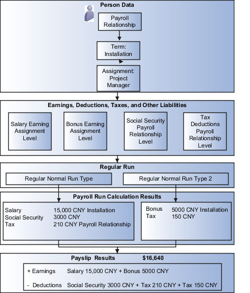

Example
This shows you how the results for a regular run calculate at the payroll relationship level of entries at the assignment, and payroll relationship level, including:
Social security tax entries processed at the payroll relationship level for the regular run
The salary element processed and paid with other earnings
The bonus element processed separately, and paid with other earnings
