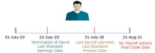

For example, David Garcia resigned from his teaching post at Royal High School, and his line manager enters a termination date of 22-July-2020. The application will process David's last payroll payment for 31-July-2020. You can view these termination dates on the payroll relationship page for David. These dates show up at all the employment levels of David, such as assignment, associated payroll, and payroll relationship.
This image shows David Garcia's payroll processing dates and the behavior of the application for handling the payroll records:
This image helps you understand the application behavior while processing the terminated employee's payroll.

Last Standard Earnings Date
22-JUL-2020
Sets the Last Standard Earnings Date as David's termination date.
Last Standard Process Date
31-JULY-2020
Sets the Last Standard Process Date as the process date of the payroll period in which David's termination occurred.
Final Close Date
31-AUG-2021
Enter a Final Close Date on David's assignment. This date will carry over to David's payroll and payroll relationship records.
The Final Close Date ends the payroll records. You can't perform any payroll actions for David after this date, such as calculate payroll, make retroactive payments, or balance adjustments.
