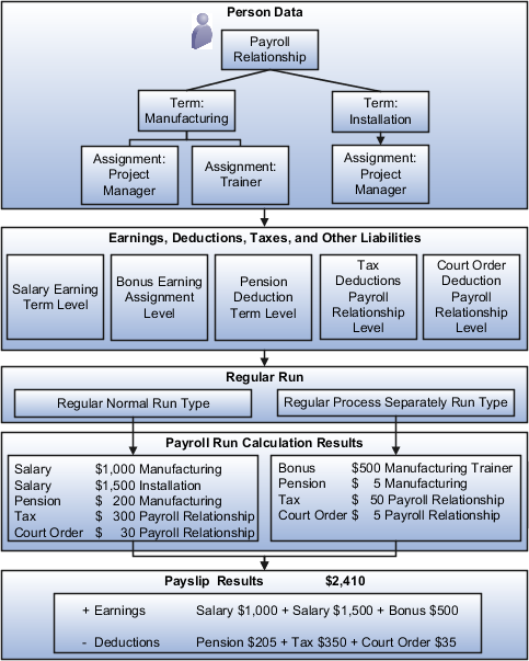

Example
This shows you how the results for a regular run calculate at the payroll relationship level of entries at the assignment, and payroll relationship level, including:
  • Pension, tax, and court order entries processed at the payroll relationship level for the regular run
  • The salary element processed and paid with other earnings
  • The bonus element processed separately, and paid with other earnings

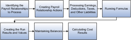

Figure shows the different phases of the payroll calculation process
