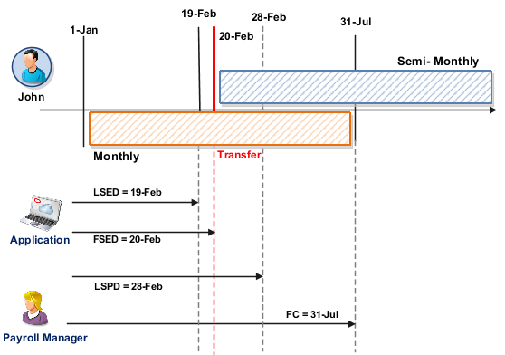

Let's consider this example.
John is on a monthly payroll, but starting 20-Feb-18, he's transferred to a semi-monthly payroll. His monthly and semi-monthly payroll definitions looks like this. You can update the final close date as 31-Jul-18.

Use this dat file to set the final close date as 31-Jul-18.
METADATA|AssignedPayroll|EffectiveStartDate|FinalCloseDate|LegislativeDataGroupName|PayrollDefinitionCode|AssignmentNumber|StartDate
MERGE|AssignedPayroll|2018/01/01|2018/07/31 00:00:00|Vision US LDG|Monthly Payroll|E10003|2018/01/01
