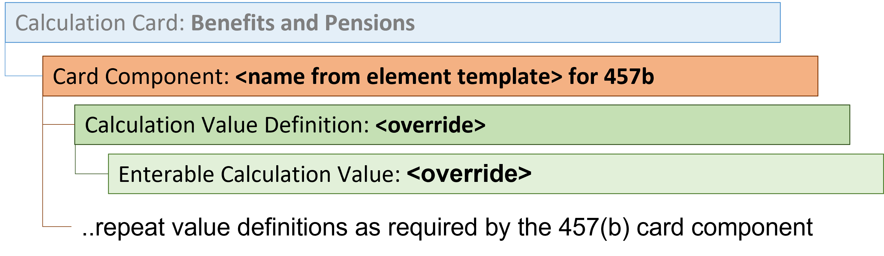

The 457 (b) card component is part of the Benefits and Pensions calculation card. The attributes to supply when creating a new Benefits and Pensions calculation card are described in the Guidelines for Loading Benefits and Pensions 403 (b) and 457 (b) Calculation Cards help topic.
The 457 (b) card component name is defined by the element template. It has multiple value definitions, which are supplied using the Calculation Value Definition and Enterable Calculation Value record types.

These attributes are supplied against the CardComponent file discriminator and must be supplied along with a CalculationCard record for the parent Benefits and Pensions card. See an example in the Example of Loading Benefits and Pensions 457 (b) help topic.

Supply these attributes against the CalculationValueDefinition file discriminator and you must supply along with a CardComponent record for the parent 457 (b) card component and a CalculationCard record for the owning Benefits and Pensions card. See an example provided in the Example of Loading Benefits and Pensions 457 (b) help topic.
Enterable Calculation Value Attributes for 457 (b)
The Enterable Calculation Value provides the override value for the value definition. It references the Calculation Value Definition record which defines the Value Definition being overridden.
The Enterable Calculation Value record type uses these attributes:
