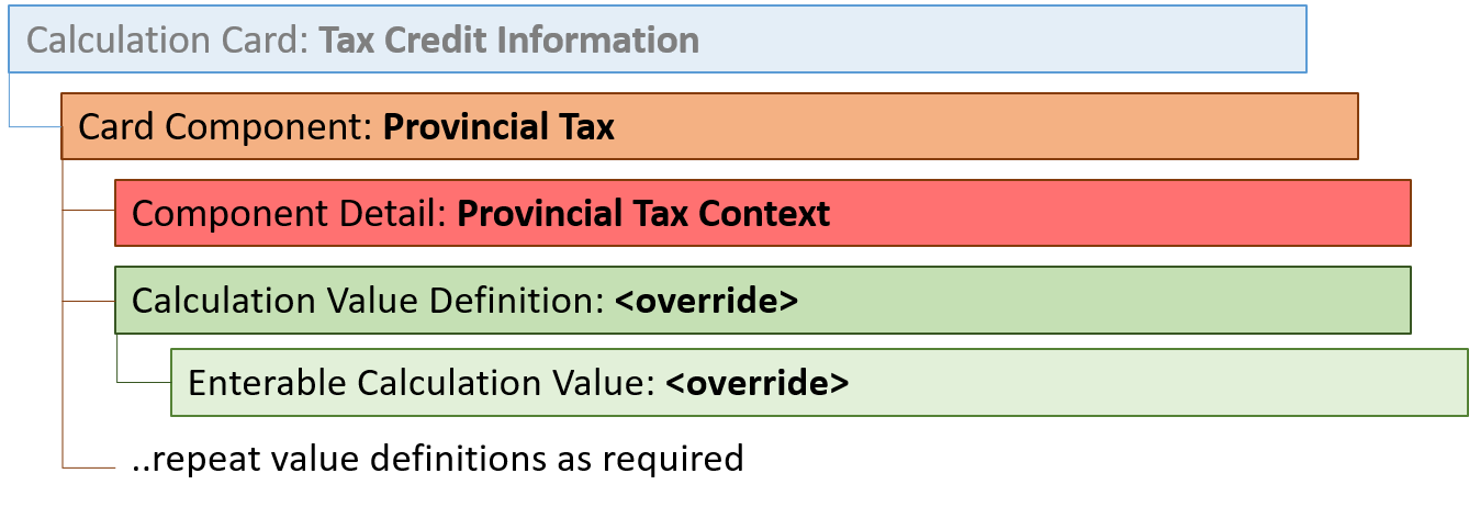

Provincial Tax Card Component Hierarchy
All provinces use the Provincial Tax Context flexfield context and data for this is supplied using the Component Detail record type. All provinces use value definitions and these are supplied using the Calculation Value Definition and Enterable Calculation Value record types. The value definitions differ across the provinces. Refer to the Value Definitions table below.
