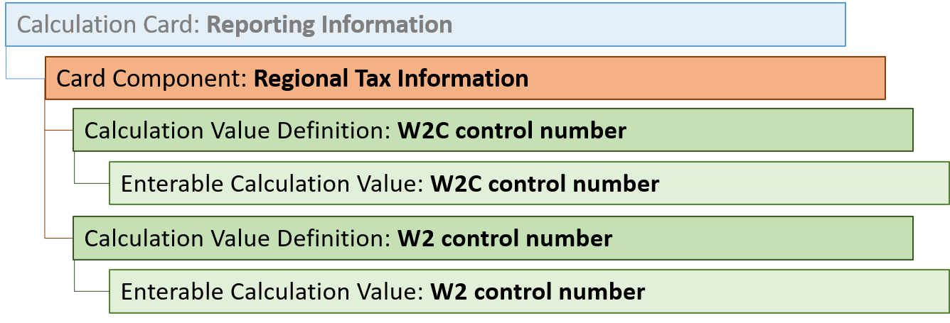

The Puerto Rico control numbers are recorded in the Regional Tax Information card component, within the Reporting Information card.
Regional Tax Information Card Component Hierarchy
The Regional Tax Information card component has two value definitions to record the Puerto Rico control numbers. The following sections describe how to supply valid file lines for these record types.
