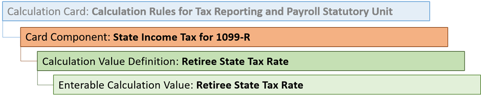

State Income Tax for 1099-R Card Component Hierarchy
The State Income Tax for 1099-R card component has this shape:
The State Income Tax for 1099-R card component uses value definitions to capture override values. Value definitions are supplied using the Calculation Value Definition and Enterable Calculation Value record types.
Refer to Guidelines for Loading Calculation Rules for Tax Reporting and Payroll Statutory Unit Cards topic for the attributes to supply for each of these record types.
Card Component
When defining the card component, specify a value of ‘State Income Tax for 1099-R’ for the DirCardCompDefName attribute on the Card Component and Calculation Value Definition records.
