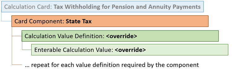

State Tax Card Component Hierarchy
The State Tax card component uses value definitions to capture override values. There are core value definitions which are applicable to all US states and additional value definitions which are state specific.
Value definitions are supplied using the Calculation Value Definition and Enterable Calculation Value record types. The following sections describe how to supply valid file lines for these record types.
